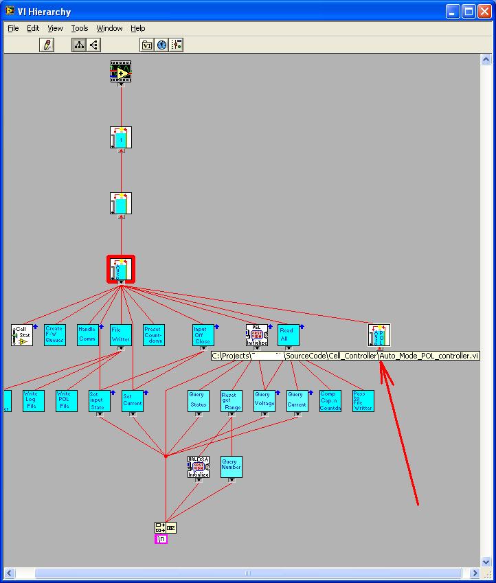

If a sub-VI is "commented out" (case scructure wired from a constant)
and
it only appears in the application in that one place
and
the FP of the VI that contains that case structures is NOT open
THen the VI does NOT show up in the hiearchy screen.
Here is a view with the FP not open.
Here is a view with the FP open.
This BUG prevents me from  verifying all of the sub-VI's have been loaded from the correct location.
Until this bug is fixed, one of the most powerful aspects of the hiearchy screen can not be used.

@Ben wrote:
(B) This BUG prevents me from  verifying all of the sub-VI's have been loaded from the correct location.
Interesting. Maybe the VI is NOT loaded into memory under these specific conditions and just gets folded into oblivion? 😉
(That icon of the subVI at the very bottom really confused me for a second. ) 😮

Yes the VI is not loaded into memory until I open the FP of the caller. I verified this by using "All VI's in memory". This is probably the method being used for the hiearchy and was just fine for LV 7.1 and below.
BUT, the hiearchy screen should show me all of the VI's in my application call hiearchy.
That icon at the bottom was a expediant solution to the question "How can quickly add a "\n" to all of my transmitted strings. Pop-up on the wire and insert.

Workaround: Change the constant to a control. If you don't want the control to be visible, hide it.
Bug? - Because of the constant, we know the VI in question is not being called by the application, so it seems correct that it doesn't show up. If you are really opposed to that behavior, the above workaround should suffice.

If you open an older VI that has a constant wired to a case structure, the upgrading process replaces the constant with a (hidden?) control explaining why.
  • Maybe replacing the constant with a control would be the most appropriate solution.
  • What if you would NOT put all code inside the case structure, but e.g. leave a few things, (e.g. the error terminals) outside the case?
