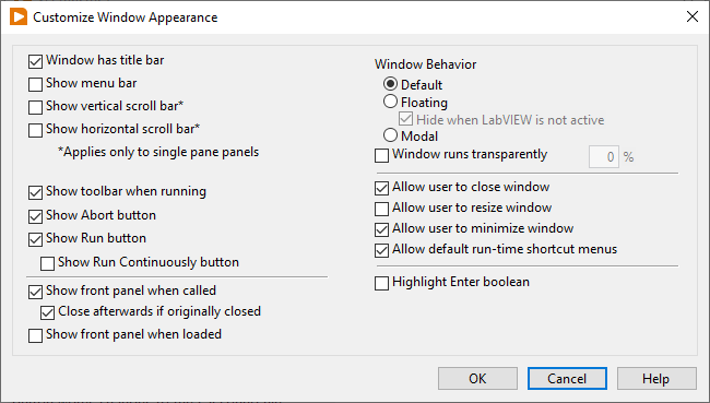

Just want to add some images of properties:
Main VI
Main VI - Execute PropertiesMain VI - Execute Properties
SubVI
SubVI - Execute PropertiesSubVI - Execute Properties
Main VI
Main VI - Cust Win AppearMain VI - Cust Win Appear
SubVI
SubVI - Cust Win AppearSubVI - Cust Win Appear
Message 13 of 14
(488 Views)
This has been solved.  I started tweaking the build specification and by adding some folders to the ALWAYS INCLUDE area, the build would break - with the complaint of a broken VI.  After I removed the broken VIs and removed those folders from ALWAYS INCLUDE, the build completed and ran as expected.
If this was the root cause, it surprises me that the build completed and main VI ran at all.
Anyway, thanks for the folks who put time into helping me out.
