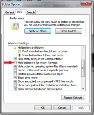

You didn't include any VI for us to look at, which makes it very difficult to debug. Just guessing from what you posted, here are a couple of things to try.
  • The SubVI uses “Read Delimited File” and has a directory input to “Read Delimited File” and the directory is set to a default path, C:\folder1\folder2\folder n\file
Is the default path supposed to point to a "file" or "directory"? Which is it?
  • before running the main VI, the file to be read is created in the user end computer
  • C:\folder1\folder2\folder n\file
Your filename is "file" with no extension. Does the file being created have the same file extension? Do you have the files extensions hidden in the folder. Could it have been created instead as: file.txt, file.dat, file.csv, etc?

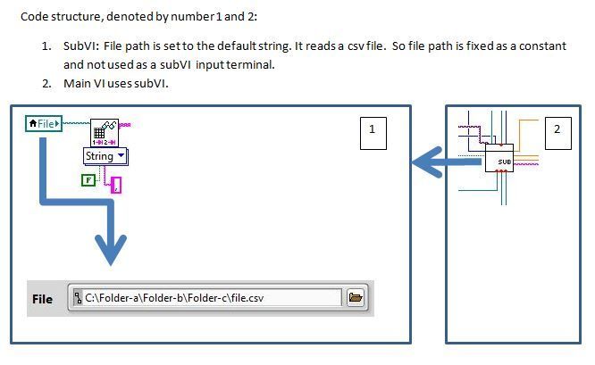

To all,
It uses an absolute path, and it's reading a csv file.  SubVI is massive.  I extracted the area in the code that relates to my question.
I don't think there's anything to do with LLB.  I included the condition of LLB in my question only to see if it might be a problem.
The flow of operation is shown in below attached image.

Hi LLVV,
are you sure about the value of that local variable of "file"?
Really sure?
Did you check the value?
Did you debug your VI (using a probe)?
Btw. why do you use a local variable here?
SubVI is massive.
The way you write that is sounds like a problem (or like the source of your problem)…
Again you didn't attach the whole VI so all we can do is guessing. Attach the VI(s)!
