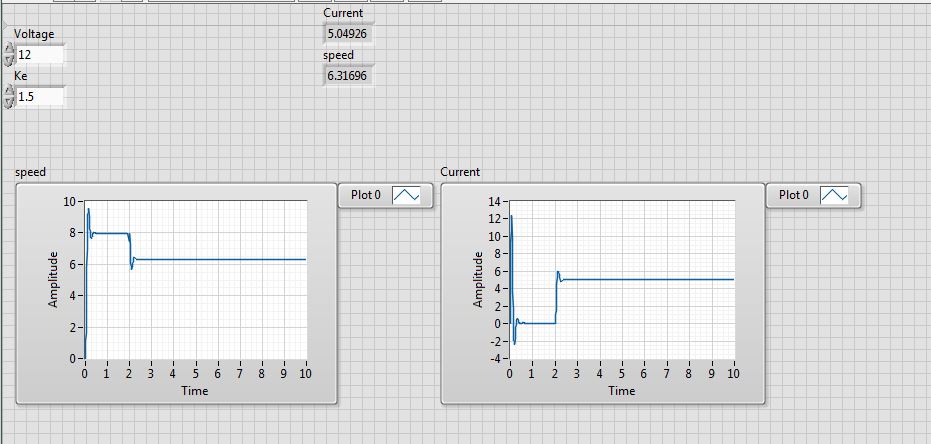

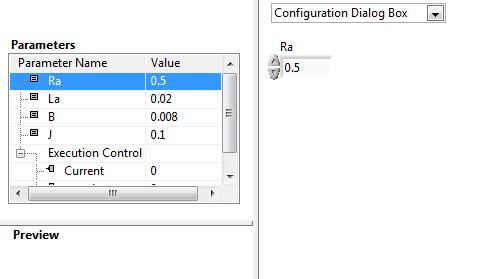

Hi shanima87,
I have place the parameter as you have mentioned using your code which you have provided by double clicking on the Subsystem 3.vi and set the values there as shown below:
The following are the results:
So the question is, what did you do to change the result? Did you get the same results as above?

Thank you very much sir. I gave the values only in the subsystem and not in the configuration dialogue box by double clicking subsystem that was the problem.once again thanking you sir.
Regards
Shanima
