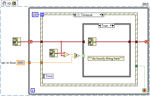

I have one more question, how would I put that in a case structure that will run only hourly. Is the "Wait(ms)" function the way to go?

Using the Wait (ms) function for such a long wait time is not a good idea. What if your program needs to stop early, before the hour is up? There is no way to stop the wait. Instead, you should write logic to check what time you started waiting and see if an hour has passed in a loop.
Here is an example of how to do this. I've put an event structure in to show you how you can respond to other events while you are waiting, such as the need to stop early.

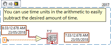

I just found that you can also use time-units in arithmetic with timestamps, for example:
So you don't need to work out how many second it is.
