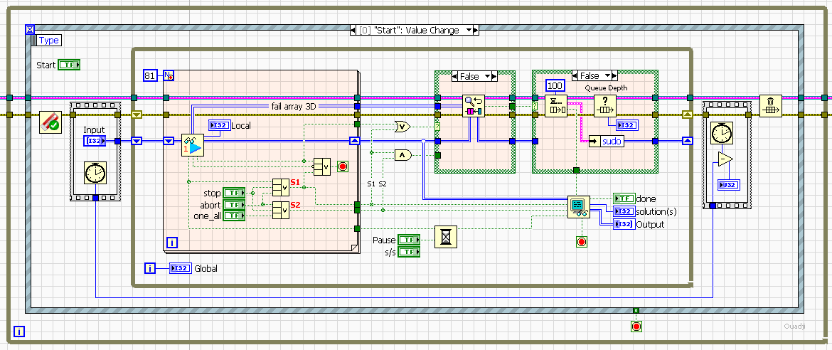

Sudoku solver with Labview
main vi : SUDOKU.vi
a) run
b) input : a sudoku by défault (very hard)
c) start ... it find the first solution.
d) toggle the switch to "all solutions"
e) start ... il find all solutions (for this sudoku, 2756 solutions)

Hi ouadji,
comments:
- I would not use (unnecessary) matrix conversions (in "possibilities"):
Your VI tends to be some ms faster without matrix operations Smiley Wink
- Just an optical issue: style guide recommends to connect error wires at the lower left/right connectors
- Just an optical issue: not everyone likes to color each structure in the block diagram
Nicely done!
thank you for this tip GerdW
ok, understood !
Nicely done!  thank you Smiley Happy
