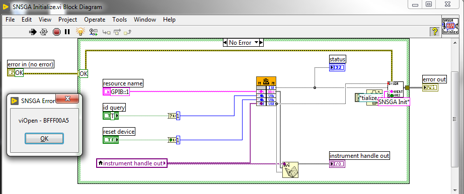

I am using a DLL that has been provided for LabVIEW that controls a power supply via one of the PCs ethernet ports.  I have made sure to properly handle all of the errors that leave the VIs provided.  However, there is still an odd popup that the DLL fires if I do not have the power supply connected:
As you can see, the popup is not the same as the error popups you normally get during "Automated Error Handling" (something which I had manually disabled and made no difference).  The library is, for some reason, not password protected or even read-only, so I can even show you the contents of the VI that launches this and even where in the execution it occurs:
So it is definitively occurring during the "Call Library Function Node" portion of the execution.  I had manually added an error indicator to the Error Out terminal on this node, and that did not prevent the popup.  So this is something beyond the realm of my experience entirely.
My question is: How do I prevent this popup?  During initialization of my program, I attempt to initialize the power supply even if it isn't connected so that I KNOW whether or not it is connected and can change behavior accordingly.  But with this behavior, the user will have to click "OK" on this dialog box any time this specific device is not connected even when the application is running in a way that does not require the power supply.

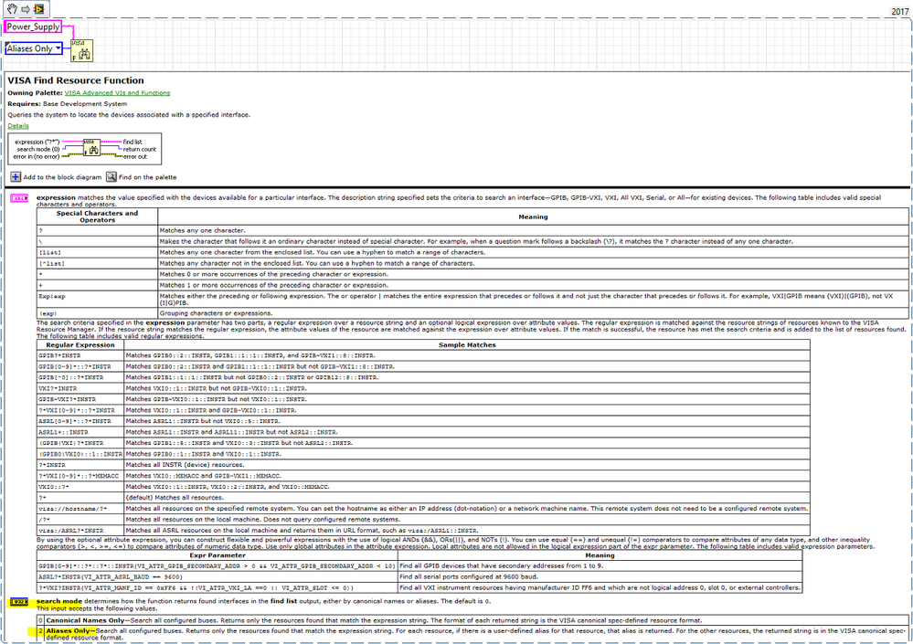

Perhaps there's another way around this one.  If I can determine that no device of the given name is connected before making the call to the library.  It is asking for a "Resource Name" as a string, but I am passing it an "instrument handle":
Is there a way to use a different VI to determine if a device called "Power_Supply" is even connected at all?  I can then skip trying to initialize it altogether.

Hi maluigario,
Let me also clarify that it is an LLB and not a DLL that I have for this device. No idea if that makes any difference.
In the image in your first post you are calling a DLL function using the CLFN: you are working with a DLL!
There is a (huge) difference: a LLB is an (old and mostly obsolete) library to bundle LabVIEW VIs (among some other LabVIEW related file formats) while a DLL is a library of functions, usable on a Windows OS.
Yes there is!

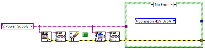

I see now the source of my confusion.  The VI that I posted earlier was a VI that was packaged with an LLB that is distrubuted by Sorenson.  The VIs in the LLB themselves call a DLL which is installed elsewhere on my PC.
Ping the device…
This software is distributed among a few different platforms and is meant to perform a few different roles, which is why we have an enum to represent which kind of power supply is connected.  On every platform, though, the power supply itself in NI-MAX is labelled as "Power_Supply".  So if possible, I do not want to start hard-coding LAN connection strings into the code.  I was looking for a way to reference the device using the NI-VISA/NI-MAX name.
roflk:
A starting point may be this Sorenson driver but I can't vouch for its compatibility with your model (we don't really know your model series number).
I had no idea that there was a repository for 3rd party LabVIEW drivers within National Instruments.  The ones you linked to definitely will work for the power supply whose DLL is giving me trouble, so thank you.  I think I found a workaround that doesn't require changing libraries, but I am going to keep this for possible future improvements.
