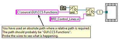

For paths to work in both development mode and an application follow these steps:
1) Use the Application Directory vi to set your path
2) In the app Build Specification under Source Files - put "Subvi folder" in the Always Included box.
3) Verify in Preview that your path exists as you expect
Founding (and only) member of AUITA - the Anti UI Thread Association.
Message 4 of 8
(4,271 Views)

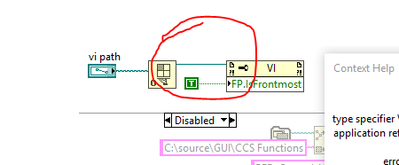

I know you're not seeing my code, so it has to be hard to help me.  However, I am struggling with what you're saying.  I am not entirely sure what I'm supposed to do with the output string generated by the code in your snippet (item 1)?  Also, I have not yet created a build, which is where I think your items 2 and 3 come into play, right?  I am clicking 'run' on main, but it's not an EXE just yet, I am just in the development mode.
To clarify, I attached two more images.  The first shows the code called from Main to display the front panel of the RFD_Control_Lines VI (this is the sniffer in my earlier (generic) description).  The second attachment are my attempts within a event handler to push the RFD_Control_Lines front panel behind that of Main.  The code in the disable block WAS in the event handler, but I tried to implement the code from you earlier solution, and it displays a "Not a Path" when I run.  I'm sure I didn't do what you were intending.
