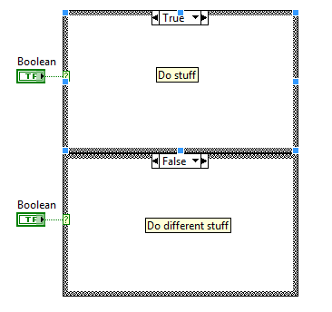

Why did you add another case structure? Just have one that has a true case that does the code inside the true case, and a false case that does the stuff in the false case.
Sorry but the picture I attached is meant to show the different code inside the (singular) case structure.
