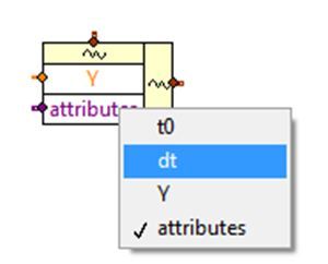

Hello experts, please help me 😞 how do i feed the time step dt using a bundle into graph so that i can obtain the symbol rate? thanks

Thank you for your post. Are you referring to the use of the "Build Waveform" node where you can wire the time step "dt"?
If this is the case you need to place down the "Build Waveform" node and expand it to reveal 2 input terminals (by clicking and draging the bottom of the node). If you click on the text "attributes" you can change it to "dt" from the dropdown menu.
Hopefully this assists with your application, please let me know if this is the parameter you were referring to.
