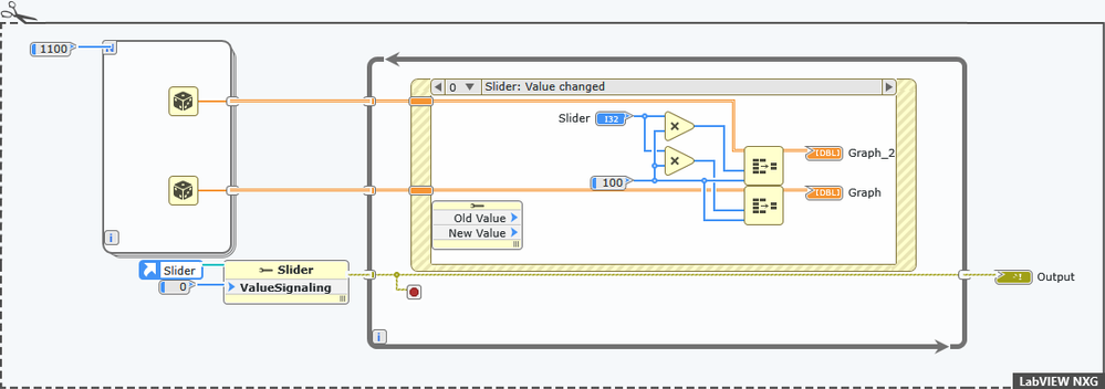

Is it possible to create a single slider that could be used to synchronize the scrolling of two charts in a NXG WebVI? Another possible solution would be to allow different ranges for the Y axis in a chart. I'm not seeing a way to accomplish either of these items at the moment. Any suggestions would be appreciated.

That's an interesting use case. With the current functions in the LabVIEW NXG 3.1.1 web module, I would try to accomplish it with something similar to this:
