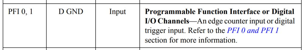

The USB-6001 uses PFI lines as inputs only, and the counter in the device can only be used to count edges - not to generate signals. It is a low cost device and so the functionality is limited compared to other DAQ devices. Your suspicion about it being the wrong device is probably true.
From page 10 of the user manual (https://www.ni.com/docs/en-US/bundle/usb-6000-6001-6002-6003-features/resource/374259a.pdf)
It sounds like you want this trigger to occur after an arbitrary amount of time, dependent on the length of the ramp signal. You may be able to use the other Analog Output channel as your trigger by writing a 5 V square pulse to the output for a few samples and then 0 V afterwards.
