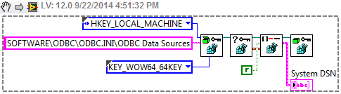

Aputman, Rolfk:
Thanks so much for your response.  I coded the picture you provided, but I received an error message:
Remote registry access denied.
Is there some Windows setting that needs to be changed?  I thought I was the admin of my computer, so I don't know that it's a rights issue.

Change the KEY_WOW64_64KEY to default or 32KEY.

Also note that the Open Registry Key.vi has a default security access mask of KEEY_READ AND KEY_WRITE access. HKLM however is for the most part a fully privileged registry part that you can only open for write access with administrative access rights. Try to open the key with only KEY_READ rights. That's enough to enumerate and read subkeys of a key. If you need to change them, you have to open the key with KEY_WRITE too, but that only succeeds if your process was started as administrator.
If you need to change any values in HKLM you need to open the key with KEY_WRITE access but that only succeeds if the process was started as administrator.

Aputman:
Thanks for the tip.  I found another way a getting around the error.  In Open Registry Key, I feed in a KEY_READ constant into the security access mask input.  The error is no longer triggered.
