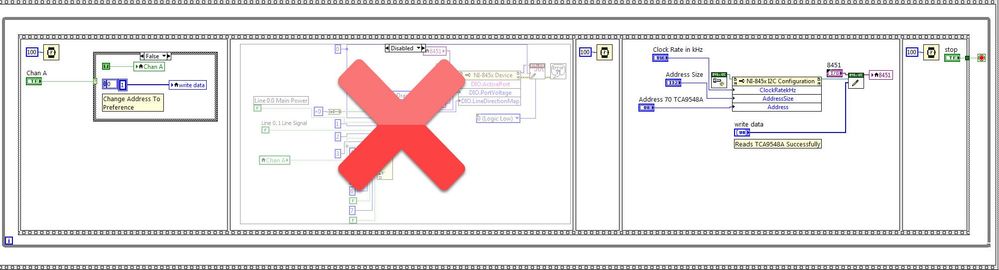

I'm glad it worked for you!  I noticed I left in some extra code you probably don't need.  That was for another switch I was using.  I don't think you need this code (Red X).2018-08-14_8-25-10 Simple.jpg
