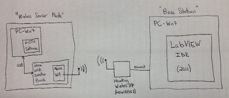

Base Station IP: 192.168.1.101
Xbee Radio IP: 192.168.1.100
PC #2 (for Xbee control using X-CTU): 192.168.1.102
Wireless Access Point: Hawking HOWABN1
System diagram:

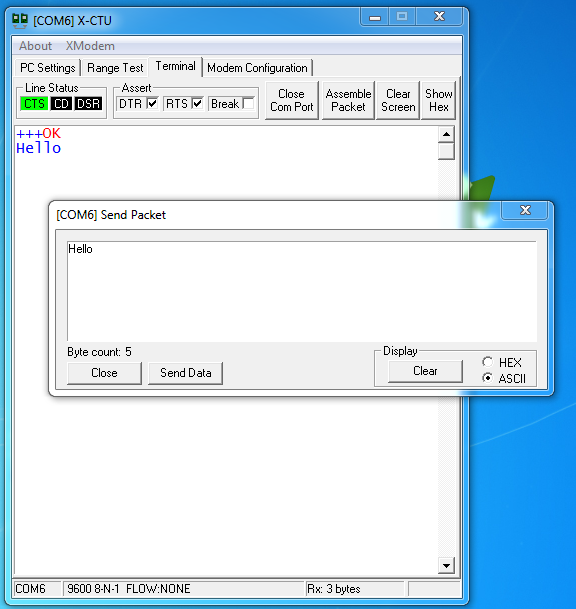

X-CTU/Xbee Configuration & Communication:

Okay. I think I made some progress.
Checking things again today, I realized that the port # is in Hex on the X-CTU software (and decimal in the other apps). I got the TCP Passive Communicator.VI to receive one line of data, but after that it errors/times out. I still cannot get the X-CTU software to read data being sent from LabVIEW.
In order to troubleshoot, I was watching packets using WireShark (and realizing no TCP connection was established). I also used another TCP listener and PuTTY to help troubleshoot (PuTTY would not work).
At this point, I'm going to switch from using X-CTU to a Python script written by another team member. This seems to be more reliable than the X-CTU software.
