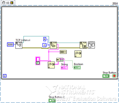

While trying to implement based on your advise, I am doing something wrong here. Could you throw some light on the same? Help in the form of screenshot or vi.

I further improved the code like this. Kindly look at both the client and server vis and help me perfect the code. (I guess changes needs to be done on the server side)

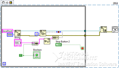

On the client side, you first read 4 bytes to get the length.  Unflatten that value to an I32 and wire that directly to the next TCP Read to read the data.

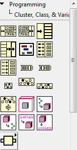

I am trying to implement this but unable to locate this bundling terminal in my palette (I am fairly new to LabVIEW).
Kindly mention the name of the bundle functionality mentioned in your code(find screenshot below) so it will be easy for me to locate.

Hi salauddin,
hint: that "bundling terminal" is getting two strings as input and gives one string as output.
Have you looked into the string functions palette?

@GerdW wrote:
Hi salauddin,
You could even say it stiches, links or concatenate the strings. 🙂

Dear GerdW, thanks a lot that I have perfected the code on the client end. Kindly help me perfect the code on the server end as well. Thank you so much in advance.
