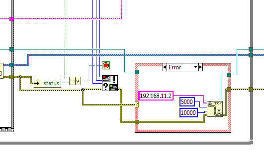

Hello Dushy_11,
you can add something like this, but it is not tested.

Pls guide and tell what need to be done
I've already said what needs to be done.
Your code shows not the slightest sign that you attempted anything like what I said above.
you're not event trying to reconnect.
You stop the loop on any error, and THEN you convert the error to a warning.
Good luck.
