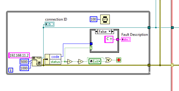

You have some basic logic problems.
Let's take a look at your first loop:
I convert that into pseudocode:
REPEAT
    OPEN CONNECTION (192.168.11.2:5000, Timeout = 1000)
    If Error, compose Fault Description.
    STOP = not (not (Error)) or Exit Button
until STOP
so... as long as the connection succeeds, you keep trying, but as soon as it fails you quit ???
Why try to connect again if it succeeds?
Also check your following logic - it looks like you ignore things (green case) if you succeed, and do stuff if you fail.

Hi Steve
I am so sorry that i forgot to remove one "not" function. Its only one "not"  function in the running code.
Actually was trying something else so put one extra "not" function and afterwards forgot to remove it while posting the code here.
