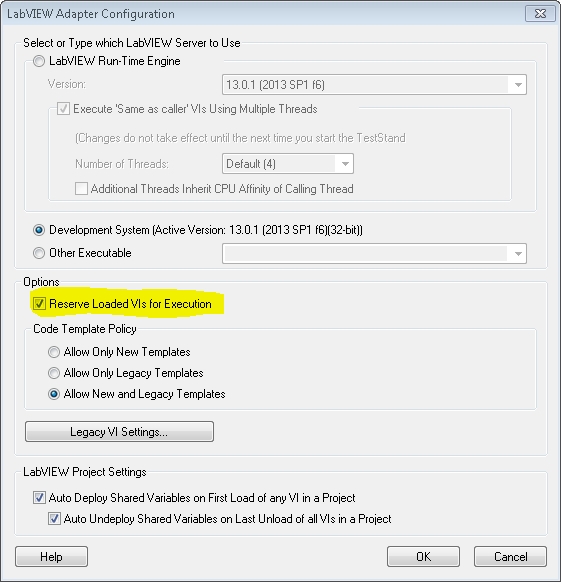

Here is a different solution that preserves the tcp-ip session between TestStand steps.
Under Configure->Adapters->LabVIEW:
I prefer using TCP-IP palette VIs for telnet because it is faster than TCP-IP over VISA (though it could just be my implementation).
Message 24 of 25
(1,181 Views)
Nice,  remember to call through the project context to avoid proxy caller namespace gotchas.
