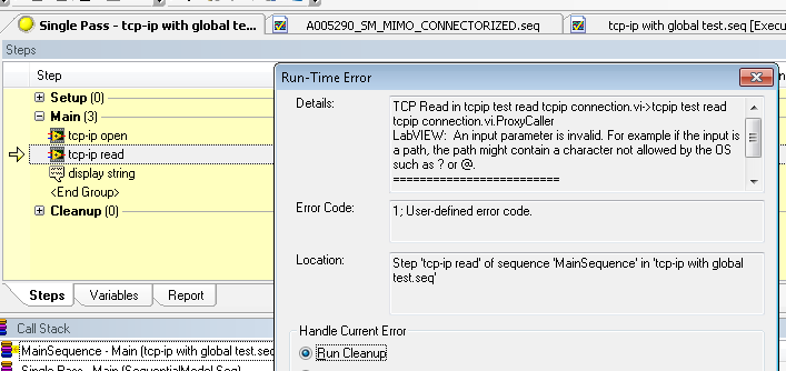

My thoughts exactly Bill, but saving the connection ID to a TestStand local variable of type number (avoiding LV globals, which I can see no reason to use) is not working. The attached sequence fails on the tcp-ip read labview step.
What does work is doing all the TCP-IP steps (open, read/write, close) in the same step for every step that needs a telnet command sent to my DUT.

Funny thing about tcp sessions
They cannot exist when all vi's in the application instance go idle (LabVIEW Garbage collection tosses them out)  So, even if you write it to a global vi, the reference will go invalid when all vi's that need it go idle.  (Sucks don't it)

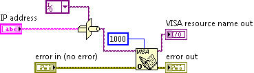

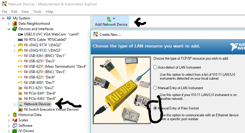

Create a TCP/IP Raw socket
Give it a nice easy alias like "MySocket"
And store the VISA Alias in the sequence locals and just use VISA
(Yeah, VISA Sessions are cool like that, they stick around as long as the vi that needs them is in memory...Caveat: don't unload the VISA open module untill you want the resource gone)

Thanks, it works if I specify the telnet session as a visa session.
It appears that I don't need to create a raw socket in NI Max as long as I pass in the 'IP address' identifier in explicitly, as (in my case) "TCPIP0::169.254.1.1::23::SOCKET".
