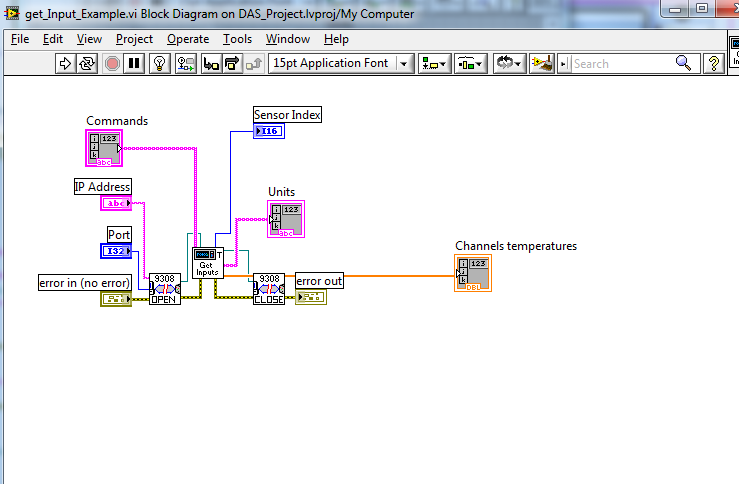

I am using a ethernet connection to query data from 2 sensors acquisition units.
This query is driven by a 30 second period timed loop.  As this rate is quite low, I close the connection and reopen it each time.
I try to connect to the unit through the same 2 ports each time, 50 000 and 50 001.
I Get the error message that the connection is already used while a TCP close connection executed w/o error before.
The network tool monitor TCP view gives me the following screen [network_connections.png] when I run w/o specifying the local port. It appears that the previous connection are not closed properlly and are still in TIME_WAIT state. This list is encreasing continuouslly, leading to networks errors. (IP adress for units are 200.0.4.152 and 153)

This appears to be a common behaviour:
http://digital.ni.com/public.nsf/allkb/119D334B8B78732E862574E1006D1839
(6,427 Views)
30 seconds is not a slow rate for network communication. Why not just leave the connection open? It will save a lot of overhead in addition to solving your error.
