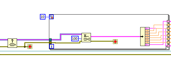

@crossrulz wrote:
When your producer stops, send a command to the consumer telling it to stop.
How do I send a command to another while loop without using the queue? Got this by getting queue status before the for loop: Capture.PNG
Was this the correct way?
Message 26 of 34
(1,499 Views)
Also I jsut noticed that using the for loop in the data write loop continously writes zeroes to all columns when the data record button is turned off. How can I prevent that? I only want it to be recording data when the data recording switch is on, and do nothing without that. but the for loop is always running and just saying the queue has zeroes in it so it writes that.
