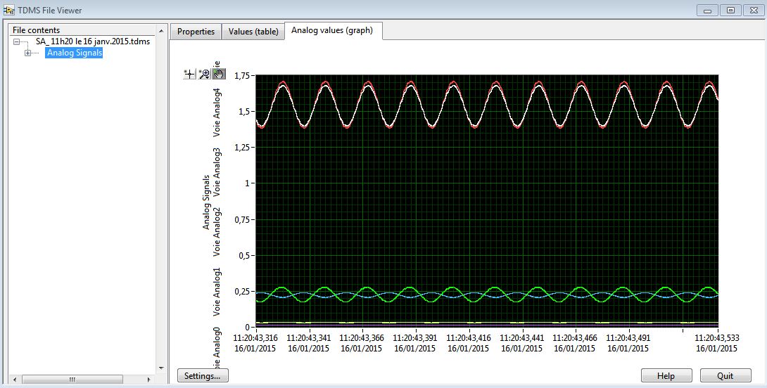

I am currently working with the TDMS File Viewer to view analog and digital signals.
But the preoblem is all my plots are mingled.
Does someone know if it is possible to get them all on top one on the other?

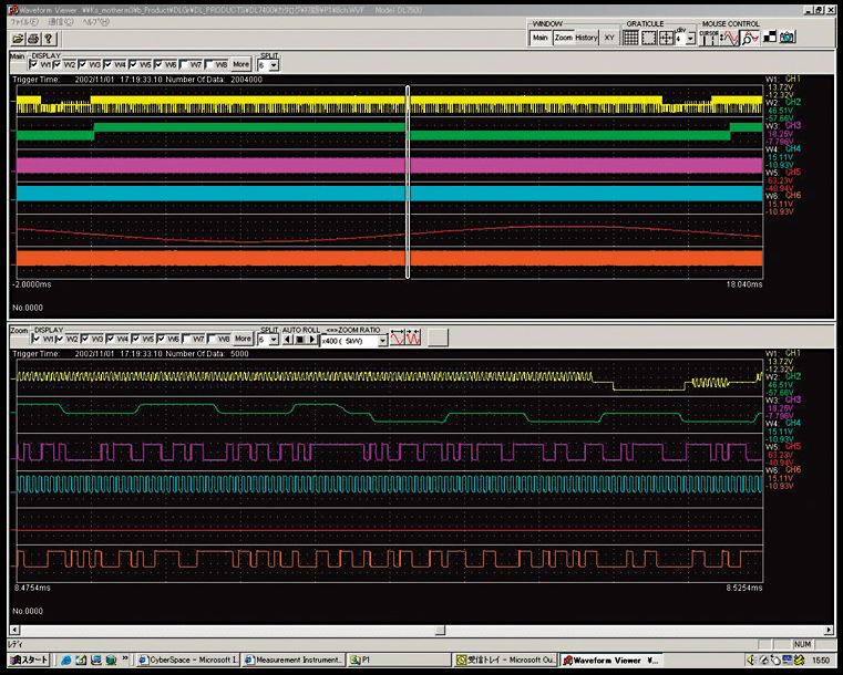

Otherwise, I am looking for a (free) LabView tool such as the Xviewer used with the Yokogawa technology.
This is very useful to compare different signals because:
  • it displays them all in the same frame, one on top of the other.
  • by zooming in a graph, the same zoom applies to every graph with the same time frame (helpful but not mandatory)
Thank you all in advance.

Do you mean that you want to view stacked plots? If yes, right click on a chart and select "Stack plot". Graph object does not natively support stack plots.
If you mean another visualization mode, can you be post an example?
