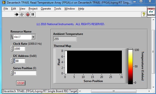

1. On the example front panel, both the ambient temperature and that on the thermal map are 255 degrees.
2. The resource name is RIO or rio://192.168.2.10/RIO0; the port is 0 as original; the I2C address is 0x68 as original and the clock rate is 1000Hz as original.

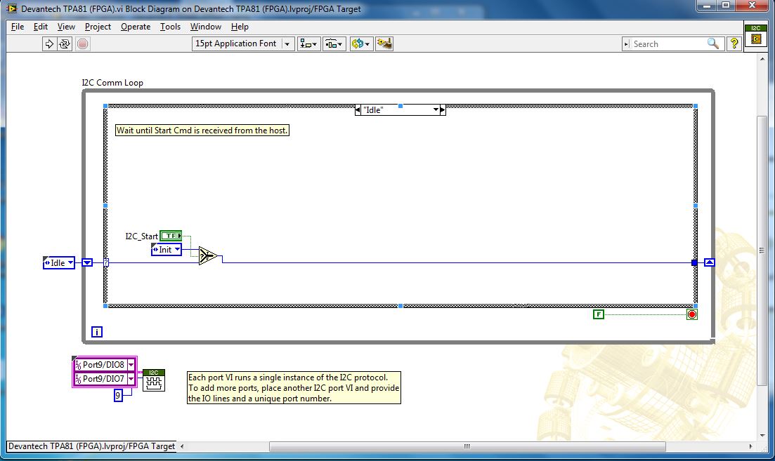

I have already choose Port 9/DIO8 as the clock channel and Port9/DIO7 as data channel while the port 0 is not the port for digital I/O I think. This is shown in the capture.jpg in the attachment.
I have also changed the port 0 to port 9 but I get nothing on my front panel. Could you help me?

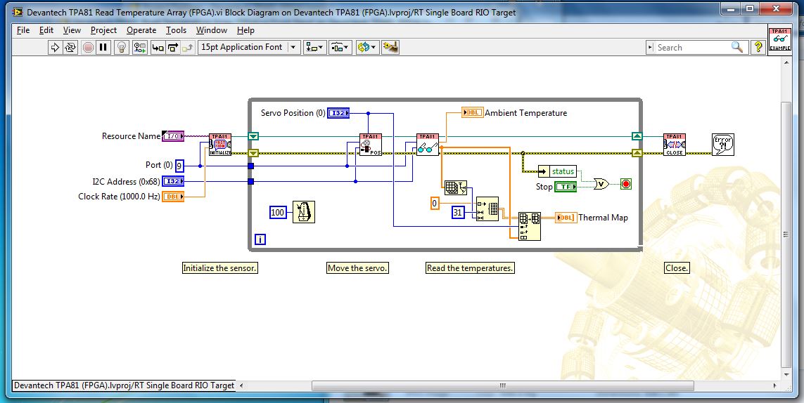

Have you changed the Devantech TPA81 Read Temperature Array (FPGA) VI to use port 9 as well?
Can you send me a screen shot of your front panel when you run this VI using port 9?

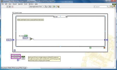

Hi Jason,
The example code is deigned to be used with port 0 of the sbRIO device at I2C address 0x68.  However, changing the code to use port 9 should not cause an issue, provided that the sensor is physically connected via this port.
Looking at the following document on the TPA81, I would have though we should be specifying I2C address 0xD0:
TPA81 Thermopile Array Technical Specification
0xD0 is the default shipped address.  Try setting the address to each of the addresses specified in this document.
