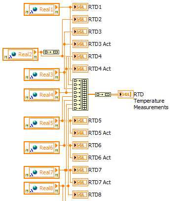

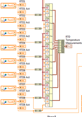

As of right now, I have 8 different waveforms built as an array that is connected to a waveform chart (with t0 being the current timestamp of the program and dt being a 1000 ms constant) in one of the tabs:
And in another one of the tabs I have a similar arrangement for a chart, except that I have 5 waveforms in it.
The thing is, with this arrangement, when there is a change of tabs, the history data of the waveform chart resets and I know that if I don't use waveforms and just bundle the data straight up into the chart, I could see all the plots separately and the data doesn't reset. But the thing is that with that approach, the X-Axis doesn't show the current date/time and I need to have that in the X-Axis.
I also know that with an XY Graph, things could be done in a simpler way, but I can't use a Graph because I'm working with properties of the plots of the chart in another part of the code.
Do you guys know about any way that I could still use the arrangement from above and prevent the data reset that I'm experiencing?

Hi Adrian,
so there is a problem in your VI, but you hesitate to attach your VI.
While there may be reasons to do so it does not help us to help you…
Why do you need to build waveforms consisting of just one sample?
Why do you need 2 indicators for each SharedVariable item?

Hi and thanks for the quick response,
I'll attach the vi, but I have a lot of other subVi's inside it and I don't think that it might run without them.
The two indicators are used to display the value that is read from the shared variable in different objects located in the front panel (a filler and a numeric indicator). This value, which is a temperature measurement, is also the one that is plotted into the chart.
I am building waveforms consisting on one sample to individually plot each one of them with the same x-axis properties. I've tried plotting only an array of all of them, but I need them to be plotted individually.
If I don't use that build array, I'm not able to build the waveforms.

HI Adrian,
is there no way to read those SharedVariables as an array of values (using one SharedVariable) instead of >50 scalar variables?
Do you really need to set a huge amount of property nodes each iteration?
Do you need to do this in a loop with a "zero millisecond" wait statement?
When you make the digital display of the fillers visible then you don't need any additional indicators!
Charts take more datatypes than array of waveforms:
You really need to cleanup the whole VI - and rethink the overall design if possible…

Hi Adrian,
@AdrianDav wrote:
If I recall correctly, in a graph there is no such thing as active plots, or am I making a mistake?
You make a mistake: graphs also support an ActivePlot property along with several plot properties…
