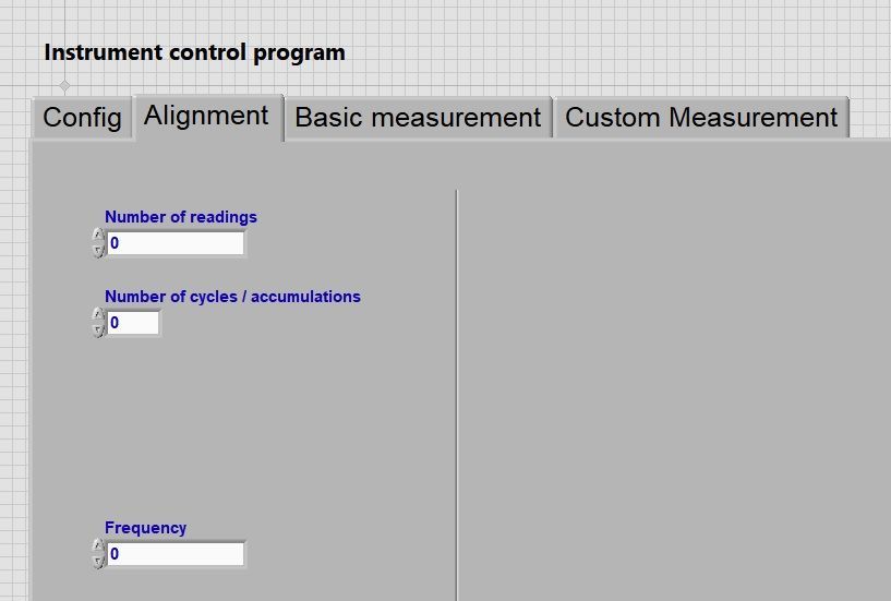

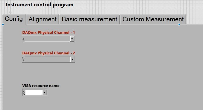

i) Config tab
ii) Alignment tab

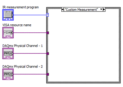

Not sure I understood your problem but if you want to have access to the DAQmx controls in multiple cases, why not placing the controls outside of the case structure?

A tab control is mostly a way to organize front panel elements. There is typically no need to wire it to a case structure or anything else. Just program as if all controls and indicators are on a flat front panel.
