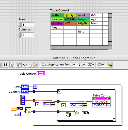

This is how to set the color for each cell as Ray.R mentioned.  I do not see any property node for the cell boundaries. It is likely that they are part of the overall control and not part of each cell.  If this is the case, then you could not change them on a per cell basis. You could customize the control and change the color of all of them, including to transparent.
Lynn
