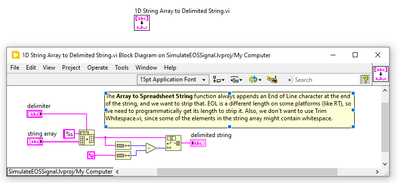

Hi siebo92,
What is your "Build Table" subVI? It looks like Express VI with a blue background, but I couldn't find one in my LabVIEW (2020 SP1, 2021)?
for your question, "1D String Array to Delimited String" should do the job
https://labviewwiki.org/wiki/1D_String_Array_to_Delimited_String_function
