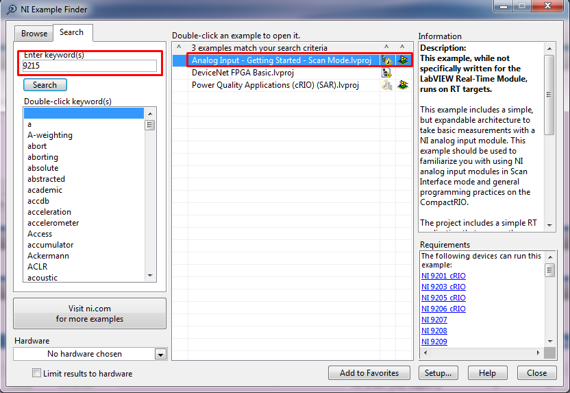

I would suggest taking the "Analog Input-Getting Started-Scan Mode.LabVIEWproj" as a starting point for your application because the thermocouple readings example projects that you can find in the Example Finder implement some Channel or Module properties not available for the NI 9215 as mentioned above (look at the picture for reference on how to find it).
This project uses the cRIO Scan Mode which lets you take measurements without having to program the FPGA. The acquisition rates you can do in that mode are most of the times enough for temperature measurements.
For this example project, you can simply set the IP address of your controller to the one in the project, but it comes with the NI 9201 module by default so you will need to discover your actual module and update the VI's block diagram with the new I/O variables in order to start reading.
