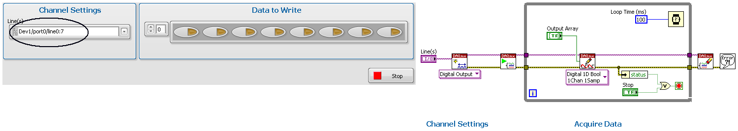

@jas1991 wrote:
Thanks apok for your response.
...but to tell the software that the DAQ will have some connections at certains ports....
you can assign the output/input's through the channel settings, whether it's a whole port (8/16/32 lines) or a single line on a different port. btw, i hate using the express vi's...
