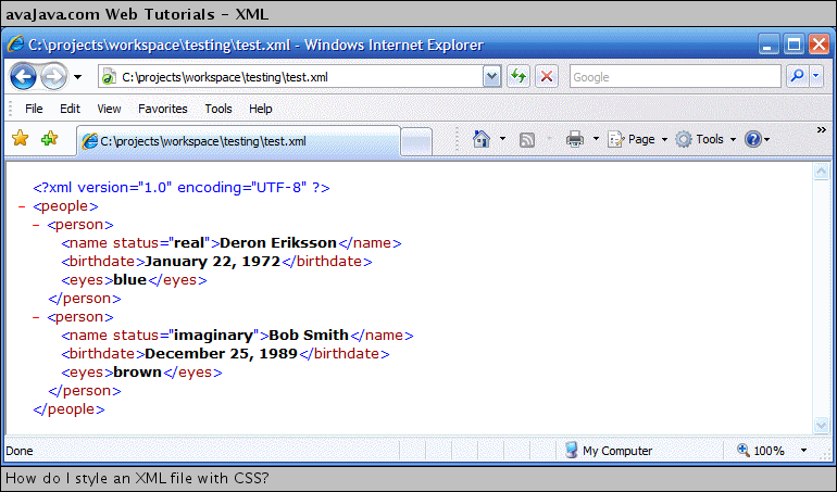

I want to have a control that shows syntax styling. The user will be entering XML; I want it to show up stylized so that text nodes show up looking different than tags which look different than attributes. I found a random example on the web:
Any ideas?
