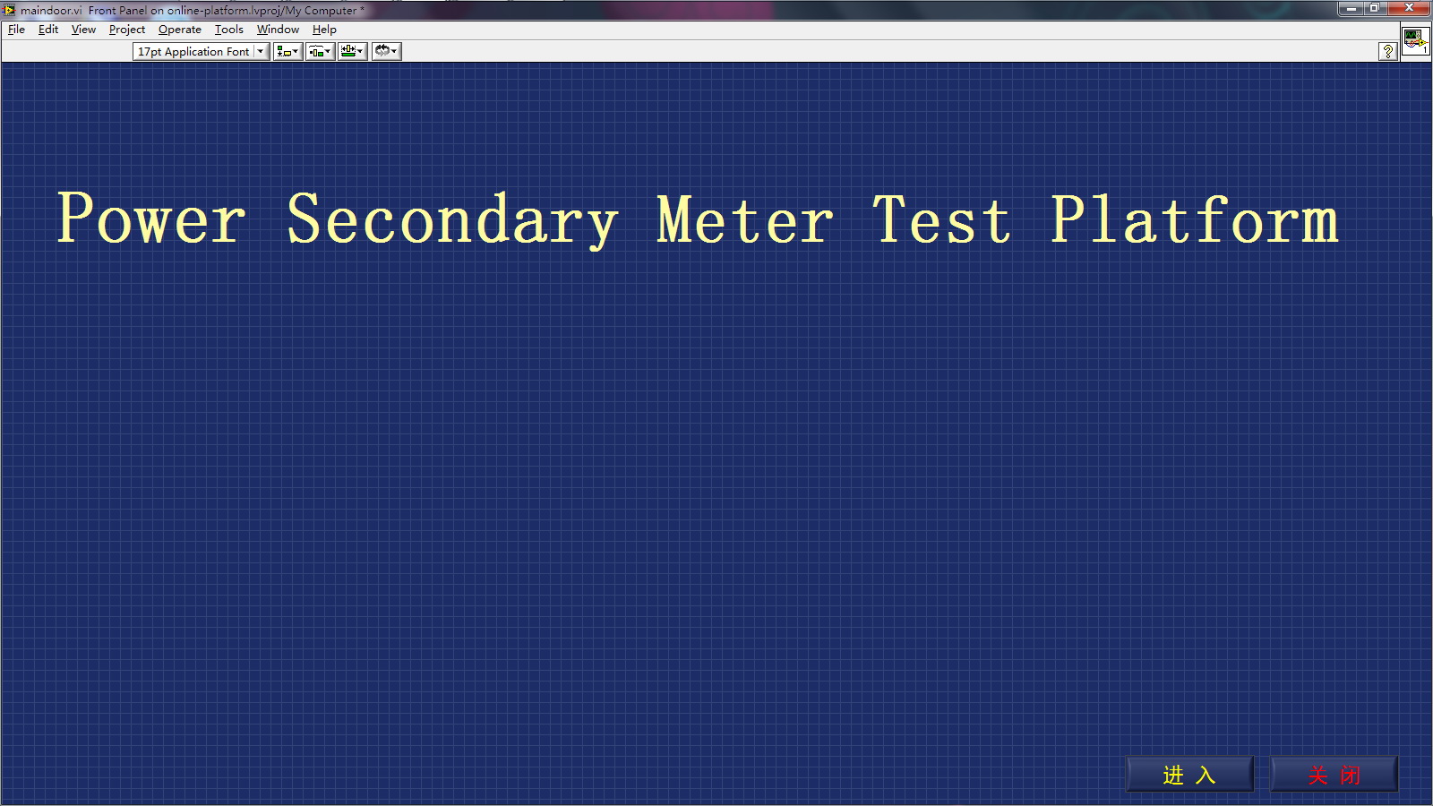

I make a text indicator to display a specific  infomation. My screen's resolution is 1600*900. But when run the application in a 1440*900 resolution notebook, the text cannot show the whole character, the tail characters allways be cut off. How to amend the problem? P.S, The properties "Maintain proportions of window for different mornitor resolution" and "Scale all objects on front panel  as the window resizes" has checked.

 Hi, the screen shot is as below.

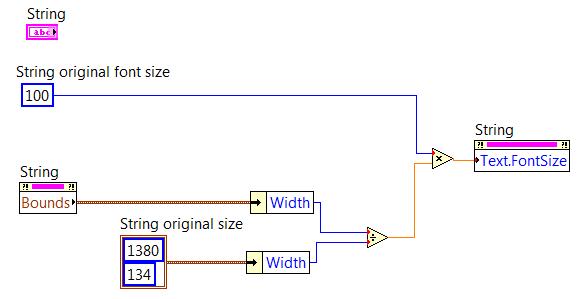

If it is just for few strings, you could do something like that:
Jean-Marc

Hi Veteran,
It just be a text string using the "Edit text" tool to create, not a string control. Because if using strin control, once click the control, the background will be highlight. So maybe your way could meet the string control length adjustment.
David

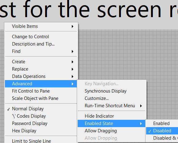

For the highlight:
