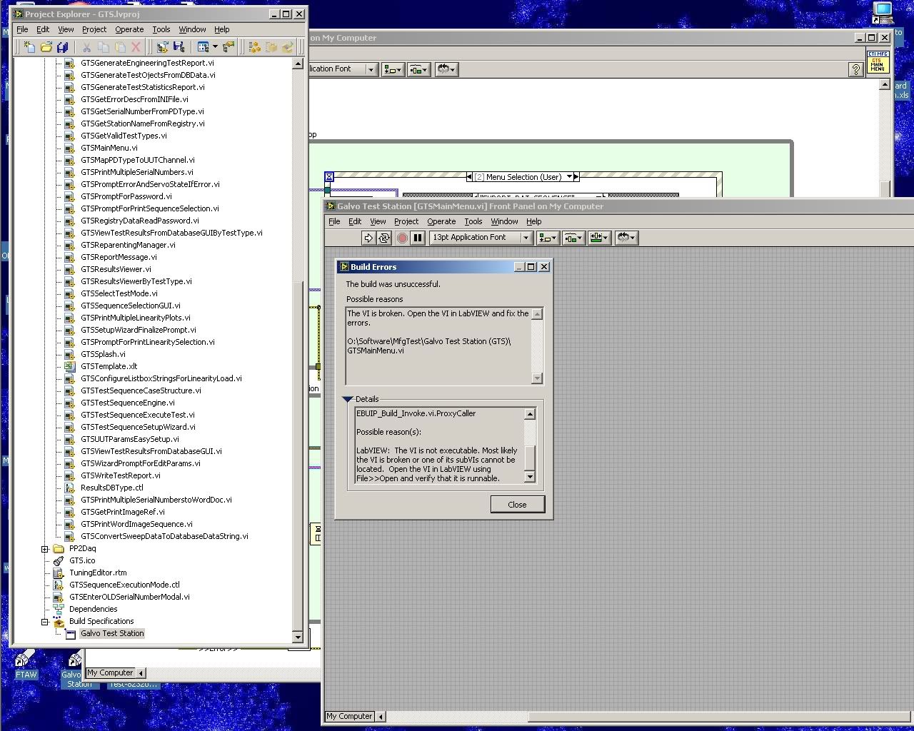

That's weird... the vi doesn't LOOK broken!?!?
Sorry NI, but after the 12,000th time getting this message I'm starting to think its too funny not to post.  Why did I upgrade to 8.2 again?

The error message is generic since typically, the reason why this error occurs is that a VI is broken outside of the build process. There are conditions where while processing VIs during building, a VI could end up broken.  The most common cause is a problem when removing typedefs and poly VIs. So the first step is to try rebuilding without removing typedefs or polys. There are other conditions that could cause problems (saving VIs during the build process that has disable structures comes to mind). Obviously, the error message could use improvement.

This application uses LVOOP.  I'm not removing unused typedef's, etc.  I found that NI bug long ago and worked my way around it.  But still, the broken vi message happens every time you change any vi in this application.  The only way to make it EVER build is to mass compile before building.
What's funny is when I asked a labview development engineer from NI in the LVOOP group about building exe's with LVOOP, his response was somethinng along the lines of "we just assumed it would build fine."  All it takes is a 5 minute LVOOP application to figure out it ain't the same as a normal build.
