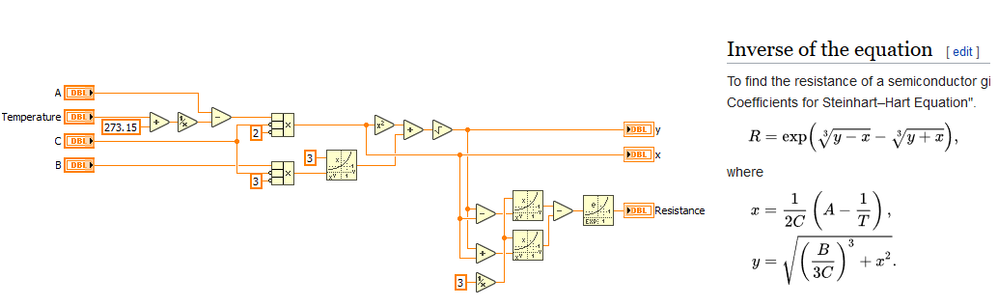

My Apologize,
    I simply thought someone might know of a vi already written to perform this operation.  I used the equation solved for R published on the NI site but I likely made an error in the formula node and I am not the best C programer and even though it does not have any syntax errors it does produce wrong results.  I would greatly appreciate any help in pointing out my mistake.
(4,766 Views)
Accepted by topic author teslac
Hi teslac,
Because you implemented the formula not correctly…
You don't need to be "the best C programmer" when you want to use LabVIEW:
