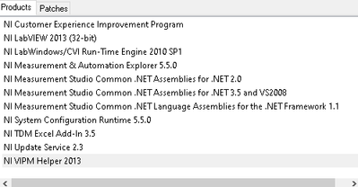

I installed labview and it started to work. After installation I had
So I started to uninstall products and it it still worked with the following.
But when I uninstalled NI Update Service the application gave a broken VI error.
