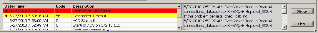

Hi Ben - thanks for the suggestion. I haven't coded the log-to-file function in yet, but I do intended to (it would be collected in a TDMS run-log). An example of what I have so far is listed below. The buttons to the right are not functional - just some future thoughts carried over from my HMI days.
The two errors (from disconnecting LAN cable), show a bit of custom 'handling - I use a case select in MAIN on the error# to append a 'human-readable' message to the bottom, "...check cabling".
You can see that it 'collects' or groups errors with the same error# - the conundrum is preventing the program from continuously reporting the error. In the ACQ code portion, the state machine simply 'blows though' execution, and if an error is present from the state, it queue's it to MAIN for display. To prevent multiple errors *of the same code* from being re-reported seems easy (crudely: within ACQ, use a shift register for last error, if same error is still present, don't queue to MAIN). However for multiple different errors? This is where the thought of a queue of errors came to mind.
