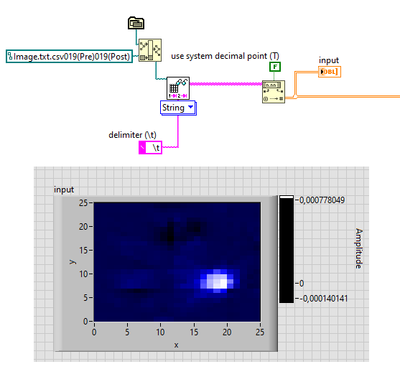

I have an image like the attached file.
I would like to convert this image to the binary values (1, 0). I will use this to compare some similar images.
Can any one help with the availability to apply the thresholding fir this image!

at first, you need to get the data from the textfile to labview
e.g. like this

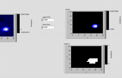

furthermore, the algorithm you propose is using only one threshold.
but as your data is in a range from -0,000140141 to 0,000778049, you need at least 2 thresholds.
can the negative part be ignored?

Yes, the negative values can be ignored
Simply, I put the data as a constant 2D array as the attached.

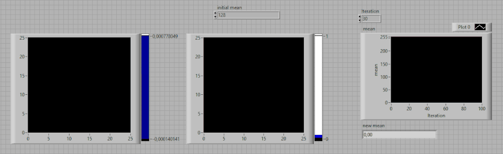

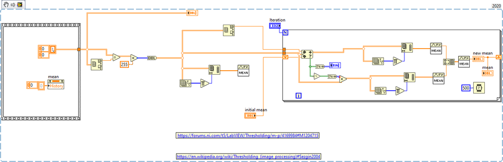

where have you got stuck?
convert the image to a range 0...255
calculate or choose the initial mean
and use in_range_and_coerce
to calculate the new images.
