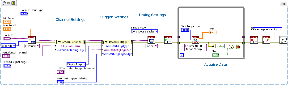

Here's a slightly modified example that adds in the use of an "Arm Start" trigger.  Counter input tasks need to be triggered this way as the standard start trigger isn't supported.
Note that the very first value buffered by this task will measure the time from the trigger edge to the 1st encoder edge.  It is *NOT* a full period.  It can still be useful though if you plan to calculate timestamps for each encoder edge relative to the initial trigger signal.  (Note: newer X-series NI boards made an ill-considered decision where they don't give you this option.  The first buffered value comes at the 2nd encoder edge after the trigger.  It really messes up trying to sync with an AI task that samples on *every* encoder edge.)
-Kevin P

Thanks a lot Kevin. Few questions though:
1. Do you think I could use this particular VI almost the way it is to generate my time readings for every encoder edge? And will it give me the time relative to the previous encoder edge?
2. Do you think I can combine this with the main pressure acquisition VI I attached earlier in this forum? As in, can I specify the same input terminal like the terminal where I receive my encoder pulses or the exhaust top dead center trigger signal in two different VIs within the same main VI?
3. Would you happen to have the VI of the picture you attached?
