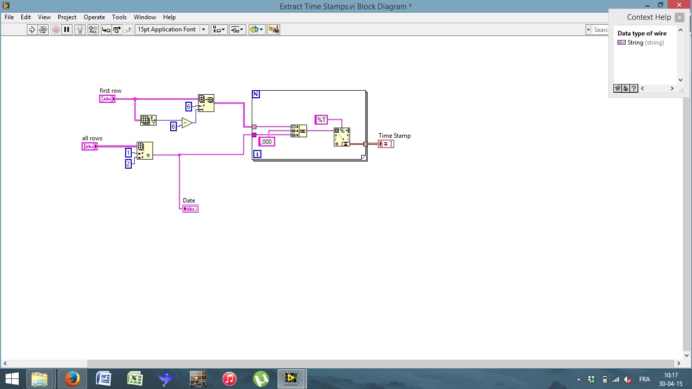

This is the VI (attached) I use to read the time stamps (the first row actually contains the time stamp in HH:MM: SS format for a whole bunch of measurements).

1. The difference in timestamp format is originated in the local PC "regional settings" regarding timestamp formats - set the same regional settings for all computers/accounts. And it is originated in your LabVIEW routine as you use the local timestamp format of the PC. Better solution to save formatted timestamps (atleast from programmer point of view): use a fixed timestamp format like %Y%m%d-%H%M%S…
2. When reading the timestamps you need to program some more checks. Reading the values could be done with a format string like "%d%1s%d%1s%d" (for the date part) - but don't forget to check for year values like "15" vs "2015"…
