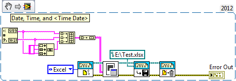

Seeing how complicated it was to write out Time information into Excel with ActiveX, I tried seeing what happened when you wrote Time using the Report Generation Toolkit alone.  I generated the current Date and Time with the Get Date/Time String function and created an array of the Date string, the Time string, and a concatenated string of <Time><space><Date>, deliberately putting Time first.  I used the Excel Easy Table function, which wants a 2D array, so I passed my 1D array through Build Array and wired it in.  I then Saved and Disposed my Test.xlsx file.
The file had the following contents:
3/27/2015 1:16 PM 3/27/2015 13:16
Note that these columns (as they are the only things in the columns) have been auto-formatted by Excel in various Date/Time formats, with the Time-Date string being shown in Date-Time order, as that's Excel's default for that column.  Although I wrote String data into these cells with LabVIEW, Excel recognized them as Dates and Times, and converted them appropriately.
Here is the code:
As you can see, this is very simple ...

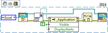

Thanks, Chembo, I hadn't played with this Property.  I suspect (though I haven't tried it) that you could also do this if you were using the Report Generation Toolkit, something like this ...
Here I'm taking advantage of the Excel Get ActiveX References to get the Application Reference to Excel, while leaving the other References in the Class Wire.  I'm assuming (but I could be wrong, I haven't tested this) that it's OK to immediately close the reference, but if not, simply don't do it!  Note that the final function, Write Table, is just an example of "Now continue doing whatever you need to do with Excel".
