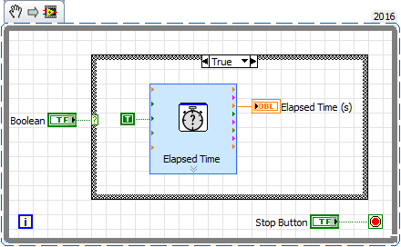

How about something like this?

Message 5 of 10
(5,610 Views)
@ameni wrote:
This ?
Please don't post garbage code that only confuses and does not work. Once the case is true, the inner while loop will run forever and all dependent code will stall until the VI is aborted.
