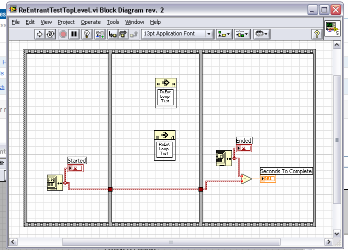

I seem to be having a problem with a timed sequence (using the LabVIEW Timed Flat Sequence Structure) when it is in a subVI that is executing as a reentratn SubVI.  I've included the a photo to show the basic structure of the top level VI I am using.
Basically I have a VI that calls a subVI several times in parallel.  I want them to act independently so I have them being called as a reentrant VI.  Within this reentrant vi is a timed sequence that executes multiple times (think to operate a relay on for a certain time, off for a certain time and then repeat a certain number of times).  When I only have one copy of this reentrant subVI in my top level VI it executes fine (ie it goes through say 10 iterations of cycling on and off for 1 second each state).  However when I put a second copy of the subVI in my toplevel the VI executes one loop of the timed sequence fine, and then seems to loose the timing information and goes a quickly as possible for the remaining loops (ie it turns the relay on and off for 1 second each state and then turns it on and off as fast as possible for the remaining 9 loops).
I've created some test VIs independent of hardware to try to isloate the problem (the picture shown).  In these VIs it is simply turning an indicator on or off and I've observed (by opening the reentrant VI during execution, and through timing the execution) this phenomenon of losing the timing for the loops after the initial loop.  The ReEnt Loop Test subVI is set to run reentrantly and take 20 seconds to complete using the timed flat sequence structure (10 loops of 1 sec on 1 sec off for indicator).  When only one is present it takes 20 seconds to complete, however when 2 are present it takes a little over 2 seconds (1 full 2 sec cycle and then as fast as possible for the remaining 9)

I still seem to be having issues.  By doing that (chaging the call setup to reload each time) I am getting the correct execution time (everything seemed fine on the test VI, only looking at the timing) but when I did the same thing to my relay control VI I still had the same problem.  The only thing that changed is that one of the instances of the subVI had the correct timing but the other 3, still executed as fast as possible.  I've included that actual VI's I'm using as well.

Yes the issue is if a timed sequence is used instead of the flat sequence structure.  The Relay Control.VI currently has a flat sequence structure because that is the fix I found.  If you replace it with a timed sequence structure you can see the problem.

 After converting the flat sequence to a timed sequence, I see the behavior you are talking about.  It took 20.093 seconds to run as a flat sequence, but only .06-.1 seconds as a timed sequence.  But if I have one one reentrant sub-VI, it took only .03 seconds to run.
