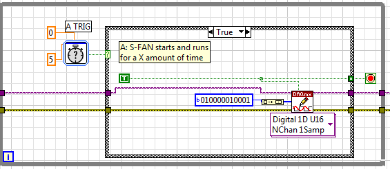

Lets take a snip of one section fixed up a bit:
You have twelve channels you must use a multiple channel write- you had a scalar U16 so I chose the 1D U16 instance, Built the array with the one element of "1021" you had and change the displat of that constant to Binary with a minimum field width of 12, 0 padded (easier to tell what bits are set that way)
Rinse and repeat for the rest.

Message 19 of 19
