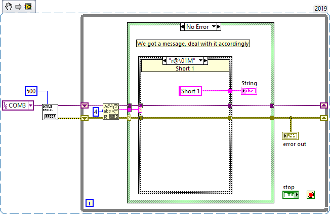

I'm having a little difficulty understanding what you want to do, but I don't think you want a state machine for it. Your state machine will read 4 bytes and check to see if it is specifically a certain message, but what if you do have a valid message that's not that specific one? Your code also will lock up execution if it isn't getting 4 bytes of data from the device for 50 seconds.
I think what you want to do is poll the device for 4 bytes of data and if you get data from it, decipher what it's saying!
This is a stripped down version, but shows you what I think you want to be doing for the serial communication aspect of your program.
