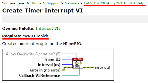

Where can I found the "Create Timer Interrupt VI" on the Labview palette?
http://zone.ni.com/reference/en-XX/help/373925B-01/myrioreference/myrioref_create_timer_irq/#Input1

Hi Hamid,
as can be seen on the page you linked to this function is part of the myRIO toolkit:

If I can call a VI by PC timer interrupt then it should be very accurate timming. I've already used the PC timer interrupt in the C programing to do a task every 1ms, but I'm not sure that VI can do that? Also, I couldn't find  the "Create Timer Interrupt VI" on the Labview palette. I installed the Rio toolkit too. It's on the help file, but once I click on the find it on the palette then it pops up an error.
Some functions are filtered according to the target they can run on.
Examples:
- On FPGA many functions from standard palettes are missing.
- You can use Watchdog functions on RIO targets, but not on Windows PC.
I guess this InterruptTimer is also very platform-specific and only available on your myRIO.
