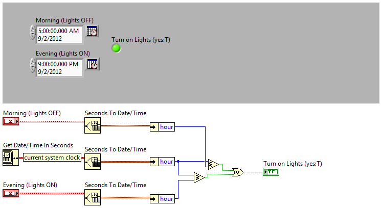

simple logic...

Hi, could you possibly explain what you've done here? Especially in the third section
Thank you

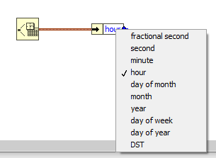

I'm sorry, let me rephrase.
There are 2 numeric time stamp controllers, which are connected to their respective "seconds to date/time" functions. There is a "Get date/time" function connected to another "seconds to date/time" function.
These 3 are then connected to some sort of arrow with the word hour beside it. What function is this specifically?
Along with that, how does this whole subVI work? The idea behind choosing these specific functions, if that makes any sense.
I'm an undergraduate student and my understanding of LabVIEW is extremely limited, I'm sorry.
Thanks a lot!
Message 7 of 8
(5,274 Views)
The date/time record is a cluster and to get any cluster element, use unbundle by name.
The current hour is compared to the set hour time points to determine state. This is independent of any programming language.
