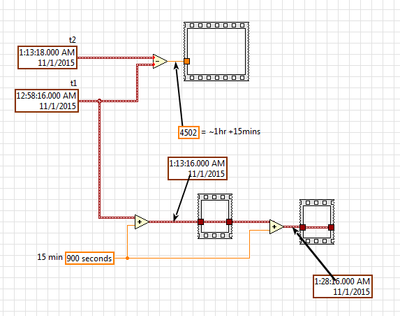

Iam having a weird behavior when subtracting two time stamps.
attached you can find pic + code
any help will be appreciated.

Daylight savings time?
Ben
(3,702 Views)
Fall back!
End of daylight savings time.
DST ended on Nov. 1 @ 2am where it then "fell back" to 1 am.  Actually there were two 1am hours during that early morning.  LabVIEW is probably giving you the time difference between 12:58 and the second 1:13 am.

Somehow the display of t2 messed up. Opening your VI on my machine (UTC+1.00) shows the following time info:
t1: 5:58:16 (7 hours off from your screenshot)
t2: 7:13:16 (6 hours off from your screenshot)
My timestamps have/show the correct values for the difference of about 4200 seconds. What happens if you close down LV and reopen the VI?

Where are you Norbert?  UTC +1 would be a European timezone.
Now I'm in EST (eastern standard) which is UTC -5.   and his timestamps showed up the same when I opened his VI.  I'm assuming he is in EST UTC-5 as well.
If you are in Europe, your daylight savings time dates might be different.  And would automatically show the extra hour built into T2 since you are straddling the time change at 6 or 7 am.  Yours would have occurred at 1-2 am, or perhaps on a completely different date.

@RavensFan wrote:
[...]  Yours would have occurred at 1-2 am, or perhaps on a completely different date.
I did not verify if daylight saving changes exactly on that specific day. AFAIK Europe is about 2 weeks different to US daylight saving changes.
So yep, it is true that i am in Europe 😉
