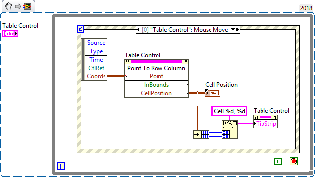

The Mouse Move event has a Coords output when the event fires. Create an Invoke Node on the table and select "Point to Row Column". Feed the Coords output from the Event structure into the Point input in the Feedback node. The output of that node will give you the specific cell over which the mouse is pointing.

I'm not sure what you mean- the code I posted works and generates a new tip strip based on table cells when you move the mouse. Did you try it? The invoke node converts pixel to table cell.

I mean that such code generated multiply events per cell (= pixels in cell width/height) instead of 1 event.

Hi Vasilich,
And what is the problem now, when it solves your original problem?
