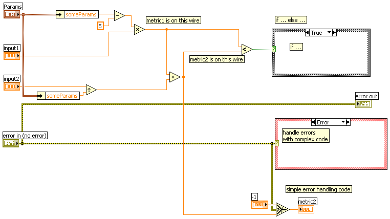

Short hints, I'll code up something...
1. The inputs will be always front panel controls. They don't cost you anything, but help you debugging.
2. The wire is the variable.
EDIT: Here is some of your code translated to LV. No you can try around and ask more specific Q's
Felix
Message Edited by F. Schubert on 04-20-2010 02:29 PM

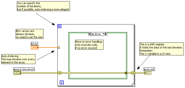

And using for-loops:
Felix
Message 5 of 34
