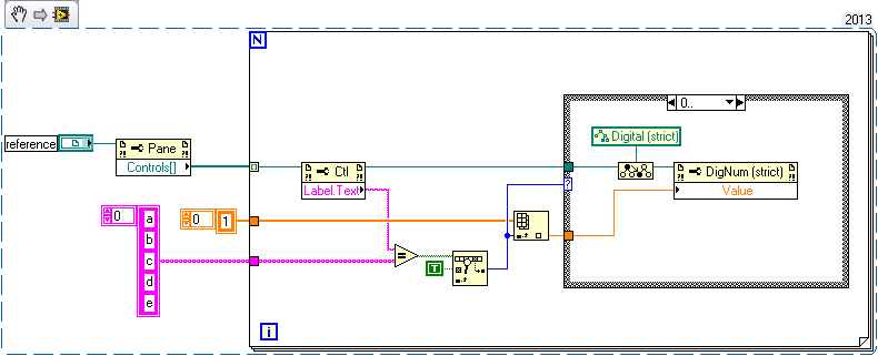

This is what I was talking about (Certainly need to tweek to make it more generalized).

Are you just trying to save and load control values?  If so then you should look at the OpenG Save Panel to INI and Load Panel From INI under the Variant Configuration palette it takes care of all of this.
Still attached is a quick example of how to do what you want.  It makes a look up table using a variant.  Then for all controls get the value from the lookup table with the same name as label, then set the value on that control.

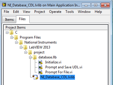

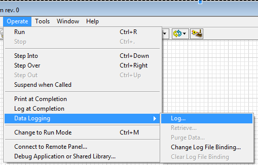

OR, "Enable Database Access" is only a right click away and "Log at completion" is fairly straightforward.  To do it progamatically just call Prompt and Save UDL.vi to create the record and Follow the help file suggestions to populate the FP data.

I get all kinds of missing dialogs when I try to use that snippet in 2013.  Where on disk is that Prompt and Save VI?  LabVIEW couldn't find it.

essentially this is the tool that runs from here:
After searching I now see that those files are part of the Database and Connectivity Toolkit and is not included with base LabVIEW.
That would make sense.  the DBC TK comes with Dev Suite and is available as an addon for LabVIEW.  That library may have nothing whatsoever to do with Operate>> Database Access>>Log...
Not a feature I often use!  but one I wanted to toss out since the discussion was going in that direction
